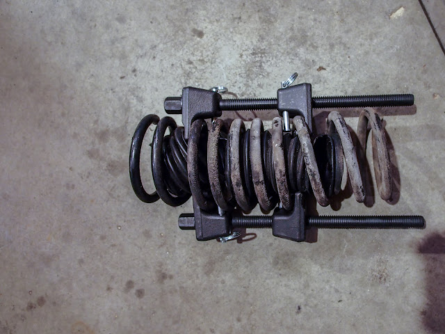

Suspension Part 2Grabbed another hour today, so I thought I'd finish off stripping down the struts. The complete unit, ready for battle: Attach some of my least favourite tools; the spring compressors. Tighten until you can rotate the top mount easily - that means the springs won't come flying off when you remove the top mount: Remove the topmounts - very straightforward, just one nut holds them to the top of the strut: Then the springs can come off, and you get the joy of taking the spring compressors off. Which takes ages when you're using hand tools: Huzzah! Getting somewhere now. Lets a look what's left - the top of the strut with a big (2" or so) hex nut: I had to buy a special tool for this: That came off nice and easy for both shocks, which is great as I thought it was going to be a total pain. Liberate the cartridges: Oh - something appears to be amiss. The passenger side cartridge seems to be completely devoid of fluid. So probably a good job I'm replacing them! And done! All ready the new inserts and springs tomorrow.

Yea but better to find out now than do the whole job and wonder why it doesn't sit right afterwards. BTW I always put a rachet strap around the spring compressors as belt and braces just in case they let go.... Cheers, Pewe.

Good tip about the ratchet straps - I had some in the Jeep as well! I'm always super careful around spring compressors, but there's always that fear. I don't know how much the "safety pin" will really do.
